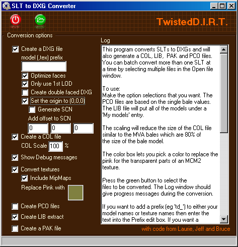

We have been working for some time on a tool to convert MCM2 SLT model files to MVA DXG, and finally we have something that we think is ready for release. We are still putting it through some final testing but here is a screen shot and some information on how to use it.
Click here to download it:
NEW Download SLTtoDXG converter  NEW - 3 May '08
Click on the image to see a fullsize screen shot.
More info..
This program converts SLTs to DXGs and will
also generate a COL, LIB,  PAK and PCO files.
You can batch convert more than one SLT at
a time by selecting multiple files in the Open file
window.
To use:
Make the option selections that you want. The
PCO files are based on the single bale values.
The LIB file will put all of the models under a
'My models' entry.
The scaling will reduce the size of the COL file
similar to the MVA bales which are 80% of
the size of the bale model.
The color box lets you pick a color to replace the
pink for the transparent parts of an MCM2
texture.
Press the green button to select the
files to be converted. The Log window should
give progress messages during the conversion.
If you want to add a prefix (eg 'td_') to either your
model names or texture names then enter the
text into the Prefix edit box. If you want a
different prefix for the DXG and the DXT then
separate them with a comma otherwise the same
prefix will be used for both.
If there is a problem with the converted model try
again without the Optimize faces check box
checked. This performs some extra poly culling
after the conversion which might cause some
problems in a few cases.
There were some problems converting models
with multiple LODs so the 'Only use 1st LOD'
check box is checked by default, but this may
work on some models, so give it a try and let us
know how it works.
Once you have converted the models you can
rename and place the mymodels.pak in the
'Media\CustomModels' folder so that UE2 can
find it. You will also need to cut & paste the LIB
extract into your models.lib file so that the
editors can find the new models. If you have
created PCO files they will need to be copied to
the 'media\pco' folder.
A TwistedD.I.R.T. production includes code from
Laurie, Jeff and Bruce. Have fun.
Laurie
